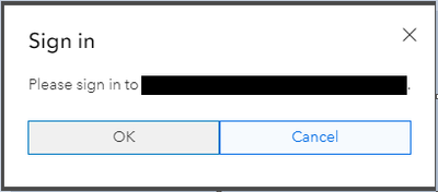

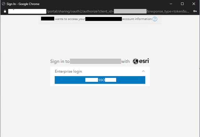

For every attempt we make to launch our web application, challenged by 2 dialogs, 1st one is for sign-in and 2nd one is for permission. Please refer to the enclosed screenshots.
This is happening for the 1st attempt and all the subsequent attempts in the same browser (Google Chrome), different tabs. Even two consecutive attempts in the same browser’s different tabs have this behavior.
Screenshot-1
Screenshot-2: This is appearing when clicked OK in Screenshot-1
These both dialogs were impacting smooth Single Sign-On user experience for our web application. How to suppress/handle both the dialogs?

Thanks for your feedback. But the behavior you described should be as expected. It is designed by js-api.
The first popup as above Screenshot-1 shows with OK/Cancel is actually to ask browser to allow actual login popup, which is as Screenshot-2.  Since sometimes browser will block popup, the popup (screenshot-1) is to ensure the correct display of actual login page (screenshot-2)
