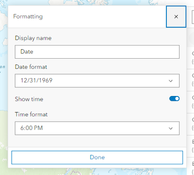

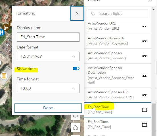

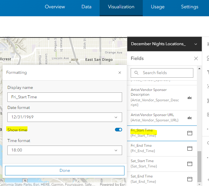

How do I show the time with Dynamic Content in a List widget?
The list widget is showing the date, but not the time.
I checked the map viewer, show time is on
Thought maybe it' a layer setting, show time is on there as well
I can't seem to find an option in Exb to toggle Show time on / off

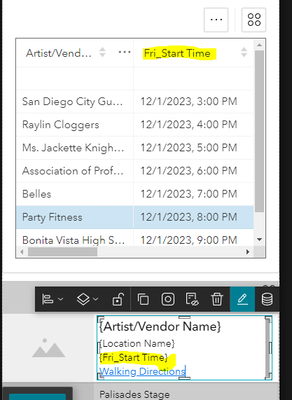

It really odd, if I add a table, it the date and time shows.  However not in a list.
With the table widget showing date/time, is there some sort of setting in the list widget that needs to be configured?

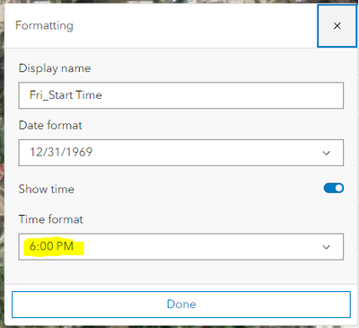

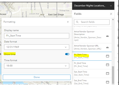

I think I figured it out.  The time format matters set in map viewer matters for Experience builder.

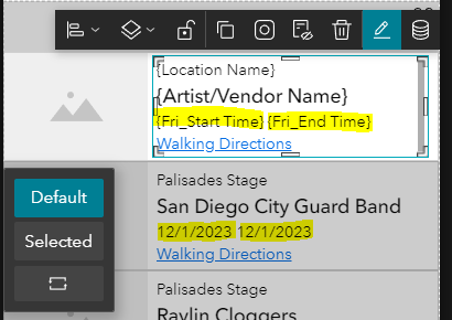

Time Format 18:00, time will not show in a Exb list.

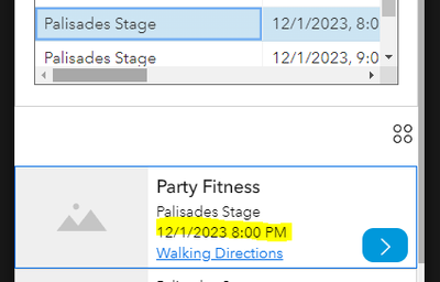

Time Format 6:00pm, time will show in a Exb list.
Is this a bug? Or should I submit an idea to include all time formats in a Exb list?

When I use a Time Format 18:00, the list widget still shows the time, but not in the correct format (another bug). Could you share a sample app with me, providing an example of a scenario where the time is not displayed in the list widget?

It appears to have partially corrected itself, I am not longer able to replicate the error using the new map viewer.
I am now able to see times in the list in exb.  You are correct 18:00 and 18:00:00 formats are being ignored.
