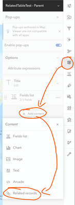

In the new map viewer, click the Pop-ups icon on the right side, then click Add content. From there, you should see an option to add related records.

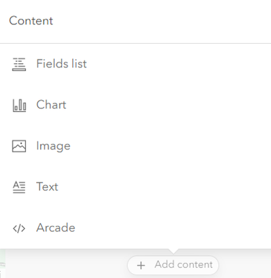

Still doesn't appear to be working, any ideas?
I tried republishing the data using the newest pro and it works as expected in map viewer classic, but no option to add relates to content in the new version
