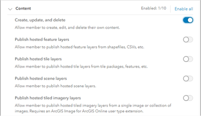

I need to give admin role to have this button :

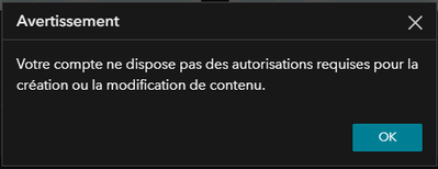

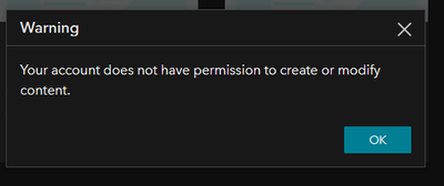

and even i see the other app when i click on an app which is not mine , I have this alert and i can't open it:

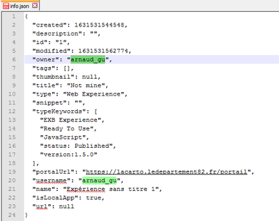

I found i can modify info.json to change owner but it will be better to have an owner and some contributor.

@GuillaumeArnaud by design, only admins and content owners can edit the content beloging to the content owner, except if that content is shared to a group with update capabilities enabled
which will aloow members of that group to update content and apps.
This wouldn't allow another user to delete or overwrite services though. To do this, you would need to create a new user Role, with clone capabilities from your role of choice, with an added Admin privilege to be able to update, delete other users content.

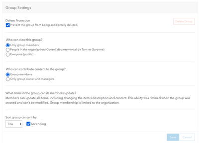

I tried to apply the change you indicated to the portal group that references the Experience Builder app but that doesn't solve the problem.
Indeed, I see the application, I can download it but when I click on it to modify it, I have the message indicating to me that my account does not have the authorization for the creation or modification of content.
My account is org_admin.
Group parameter :
GuillaumeArnaud_0-1631531989945.pngGuillaumeArnaud_1-1631532035367.pngGuillaumeArnaud_2-1631532074273.png
To permit modifcation I need to modify info.json file of app :
