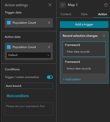

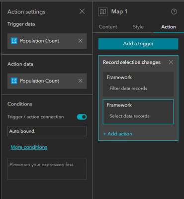

I would like my chart to filter, select and zoom to selected features in the map. At the moment it selects and filters but does not zoom to the features.
This is how my chart actions are set up
And this is the map
Any pointers would be greatly appreciated thanks 🙂

I dug for a while and found that this should be a known limitation at this moment. For W-Chart & W-Map interactions, there are only Flash and Filter supported. It appears that the options of "Zoom" and "Pan" in the Chart widget were not removed from the UI so it is documented here: ExB Chart widget > interaction options note
For this function itself -
From my understanding, unlike the Query widget, which directly utilizes the added data source, Chart creates an output data source (i.e. Chart statistics) right when data gets rendered. Once that happens, it lost all geospatial reference, thus, there is no way to get the extent for zoom or pan which depends on geometry, when you select anything from the Chart widget.
