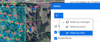

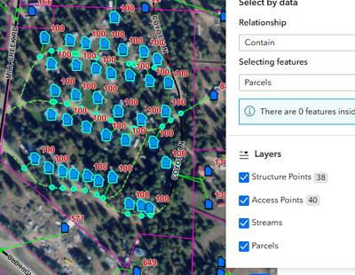

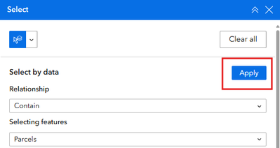

If you decide that the Select widget is the way to go, this seems to work for me:
1. Enable "spatial selection" on the Select widget configuration, with your parishes as the selecting data.
2. Open your Experience and open the Select widget (unless it's configured to open automatically on load).
3. Click a parish to select it.
4. In the Select widget, activate the tool by clicking the button in the upper right so it turns blue**, then click the dropdown and choose Select by Data:
5. Click Apply:
Now your features from the other layer are selected:
** I wonder if this is where you're running into trouble, since it doesn't really make sense to me that you would have to activate the interactive selection tool to use Select by Data, but you do.

Hi Dave, yes you would have to specify the layers in an Arcade expression and configure the popup according to your layers/expression(s). Possibly a better user experience but you'd have to decide if maintaining is worth it if your map layers change frequently.
5. Click Apply:
davidchamberlain2
Thank you @JRhodes . I was indeed running into trouble because of not realising I had to use the interactive selection tool to use the selection by data tool! Thank you!
