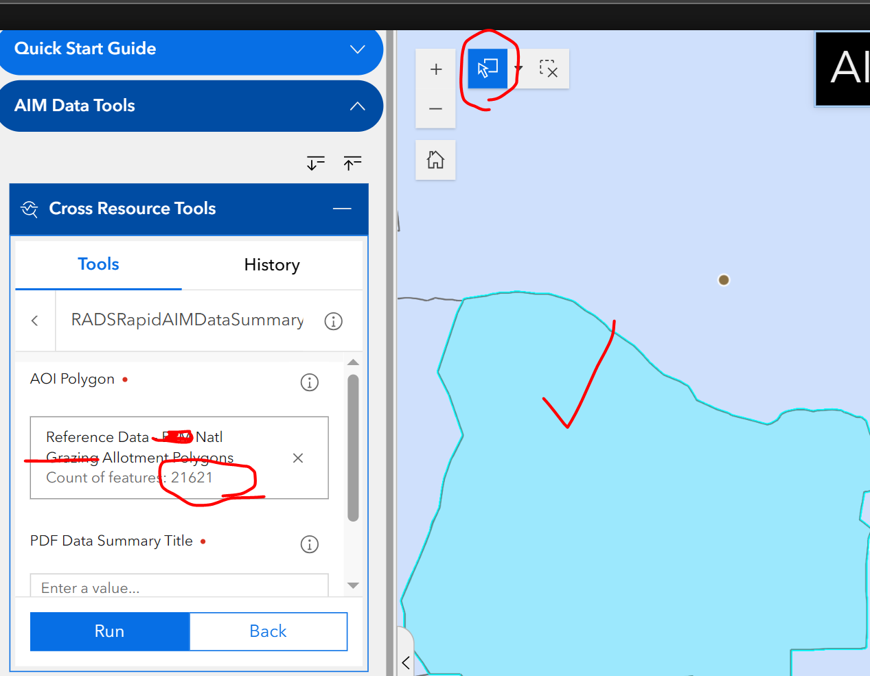

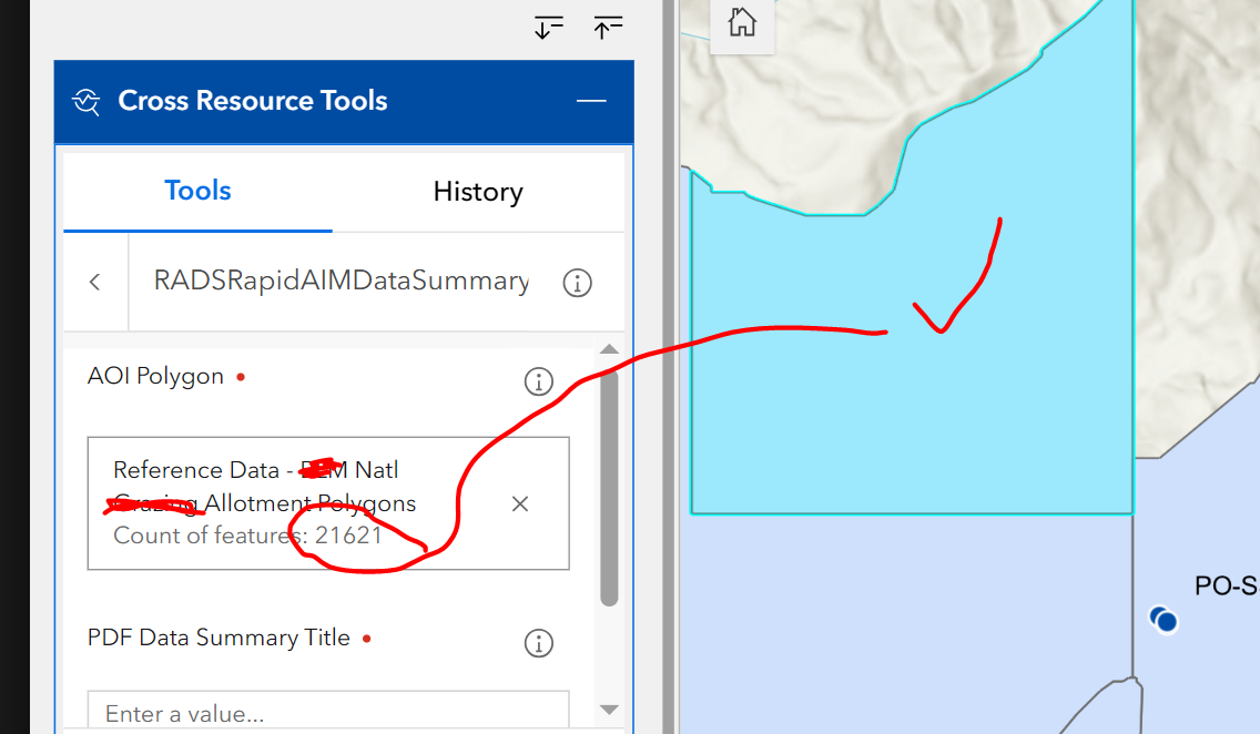

Second if I make a selection first then set that layer as Input to my Analysis widget tool it totally ignores the selection.

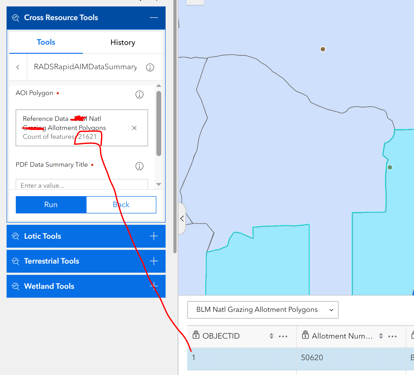

Same deal with the table widget - totally ignores selection.

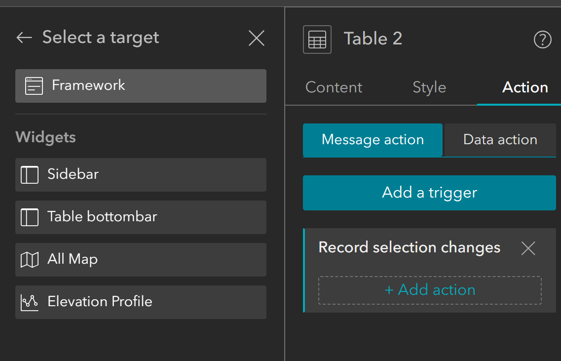

And no message action from table widget to the Analysis widget at all.

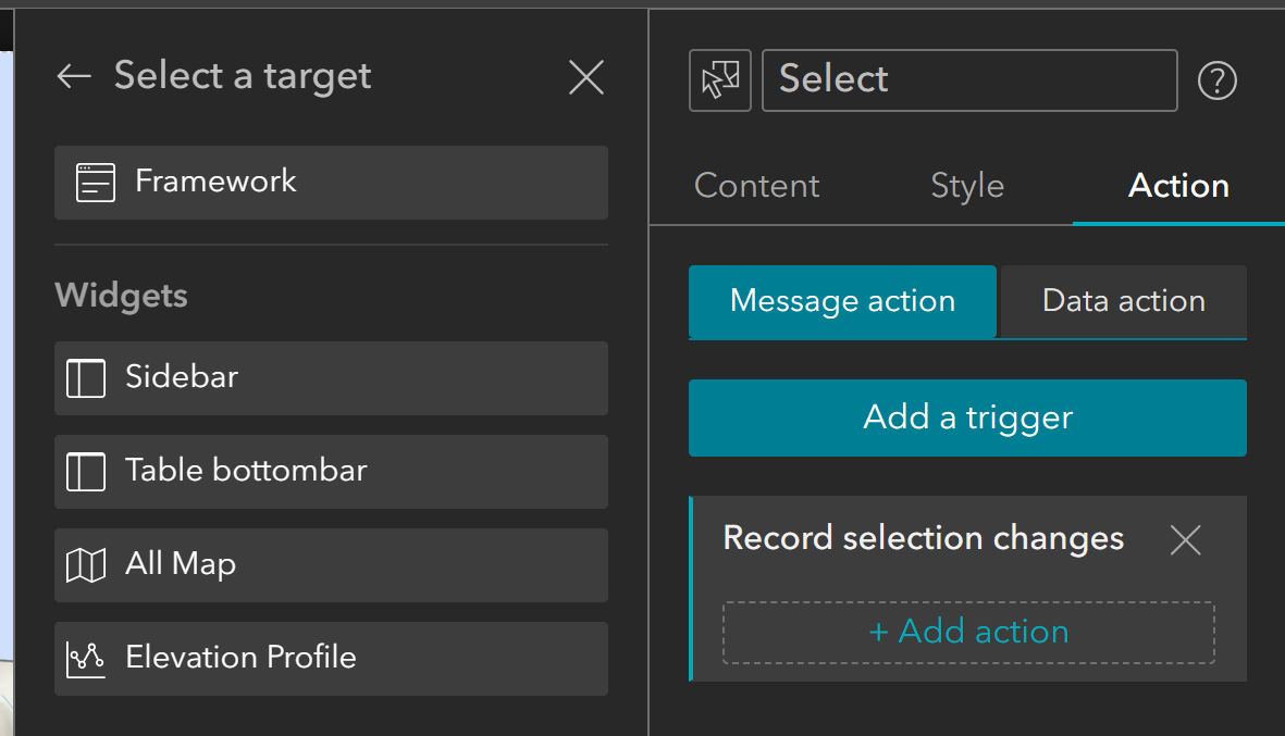

Also same deal with the Select inside the map widget itself.  And again no Message action to my widget.
