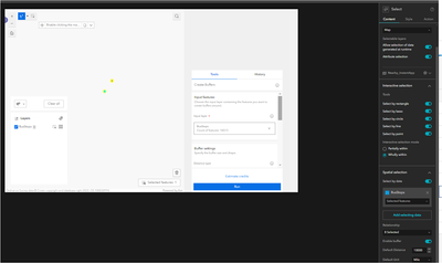

I have tried to make the two widgets work together but I cannot find a way to link them either. There are options in the select widget to make a buffer using the spatial interaction, the yellow circle outlined is the buffer created. The settings on the right-hand side are for the select widget.
