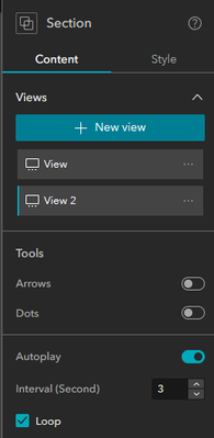

Hi there,
Just created a blank new experience builder on ArcGIS Online and added the Section Widget and two views.  Tested and it seems that the Autoplay functionality is not working.  Is it only me or if there is any potential workaround?
