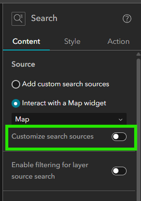

Hello @SanchezNuñez
Ensure you use 'Interact with a map widget' and have 'Customise search sources' toggled off.
If this is off, then the Enable filtering for layer sources can be off or on, and the point will be highlighted.
