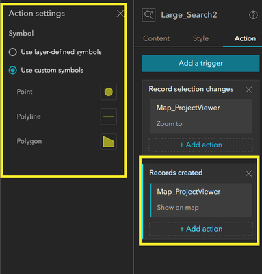

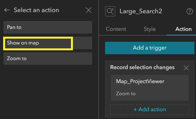

lol. I literally just did this (needed to bug Esri since it isn't obvious).
Pin on map:
  1. Select the "search" bar
  2. Go to "Action" tab
  3. Click "Add a trigger"
  4. Select "Records created"
  5. Select your data source/map
  6. Select "Show on map"
Zoom to point:
  1. Same as previous steps, but select "Record selection changes" instead of "show on map"
  2. Select your data source/map
  3. Select "Zoom to"
Pin on map:
Zoom to point:
  3. Select "Zoom to"

Thanks! This worked for highlighting the location, no popups, but I think this is good enough!
