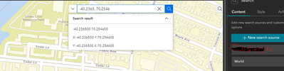

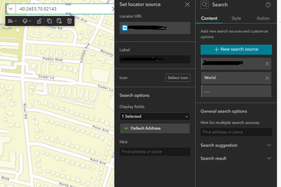

Thanks @ShengdiZhang, geocode AGO service is working as expected, our custom geocode service is not returning, we checked configurations but all look similar to AGO. Also if both sources are there it doesn't show the results at all. Please check the screenshots below
Is there any checks that we can perform
ShengdiZhang
Would you mind sharing your custom geocoding service with me? Or you can contact the Support team to see if they can help you reproduce the issue.
