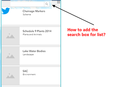

Hi,
I have added dynamic list to Experience builder. Is there is a way to add search box that will search among the listed items?

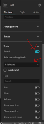

Scroll all the way down in the List Settings and open the Tools dropdown. Switch on Search and use the Select Searching Fields to decide what you want to search for.
This option will not be available on older versions of Enterprise.
