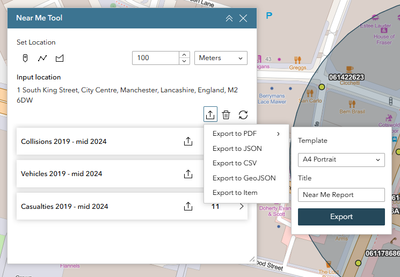

Hi @Lisetelvieira the Near Me widget should allow export to PDF, but it only comes up as an option when you click the export button at the very top of the results list:
This blog post also has some info on the PDF report in the Near Me widget that might be useful.
Hope that helps!
