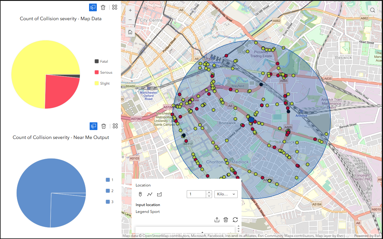

Hi all,
Is there anyway to configure charts in Experience Builder so that when the data is set to the output of the Near Me widget, they display the domains correctly? For example, I have a chart based on the data on the map and it displays the domains just fine. But when I set the chart data to the outputs of the Near Me tool, it does not display the domains, only the codes.
Does anyone know if this is a bug and/or is planned on being fixed, or if there is an easy workaround? Would love to include some charts in my app, but the data is very big so we are relying on domains for almost all of it. It's almost impossible to make sense of the charts without the domains showing properly.

Hi @AMatthews, looks like a bug from Near Me. we are looking into it, thanks for reporting.
