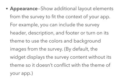

Have you enabled the survey theme within the widget?

Yes! 🙂
