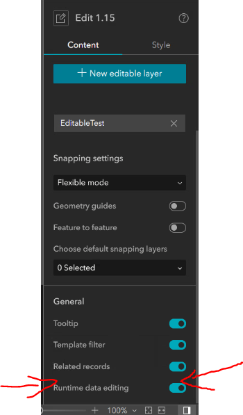

Hello,
My custom widget adds a Hosted Feature Service from Enterprise 11.3 which  contains multiple layers, thus making it a DataSourceSet in ExB terms. It uses similar logic as Add Data Widget. I then would like to be able to edit these layers using Edit Widget which from 1.15 has capability to edit runtime layers (also tested with 1.16 Edit Widget). However it does not seem to work on the group layers added to the Map/Map Layers widget.
If I add just a single layer via a URL from that hosted feature service, then I can edit it in Edit Widget. Also if i drag a layer outside of the group in the Map Layers widget and then open Edit Widget, it seems to recognize it as an editable layer, if I do it the other way around it doesnt work.
So seems like just the group layers are not supported or is it a bug?

I checked and confirmed this bug.
It has been fixed in the recent refactoring.
And the fix will be included in Dev edition 1.17.
