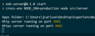

But if you really wanted to run two instances, you can find this in the /server/src/server.js file:
port=commander.port||process.env.EXB_HTTP_PORT||3e3,httpsPort=commander.https_port||process.env.EXB_HTTPS_PORT||3001
 I altered mine to read 4001 and 4002, respectively, and then got this after running npm start.

@jcarlson thank you for the information!  Your solution worked!
