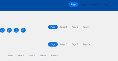

Good day all,
I'm currently trying to navigate an issue where the selected menu option background colour does not retain once you select another menu/button within the selected page. The first menu is within the header and the second is within a views navigation widget within the page. The issue also occurs after initially clicking on a button which navigates to another page (the initial menu selection colour reverts back to the default orange).Please see attached image.
Ideally I'd like to have the two menus maintain their selection colours as the user navigates through.
Are there any solutions for this? Is this a limitation of Experience Builder?
Thank you.
Dave

Emm...this does look odd. However, I am not able to reproduce what you've described here - two menus on the same page and the one inside the header shows the same selected state.
Are you on AGOL online or some specific version of the environments? Also, is it possible to share an app with me so we can take a look?

Hi TonghuiMing,
I was able to successfully replicate your case with the double menus maintaining selected colour. One major difference in the flow I have is that I have an intermediate page that uses various buttons (I'm using that similar to a menu) to navigate to the page that would have the views navigator. I think that is the main issue in it not maintaining the selected menu colour. The redirect in the buttons breaks the header menu selection.
I am unable to share this particular app.
