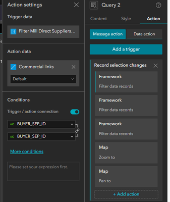

I have the same issue described by  Sophia
I have one query widget in EB and it uses two different feature layers.
If I apply one of them and then I reset or clear the results, the map and other widgets do not come back to the previous state or default view
You said:  remove the selection manually, but I'm not selecting anything just filtering.
Add action ----> Framework ------> Filter data records, and select the conditions to the trigger and action connection.
All the time, I have to refresh the whole page to bring it back to the default view.
Any clues how to solve this?
