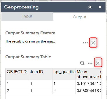

Hello Everyone,

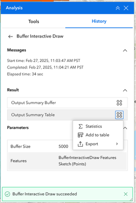

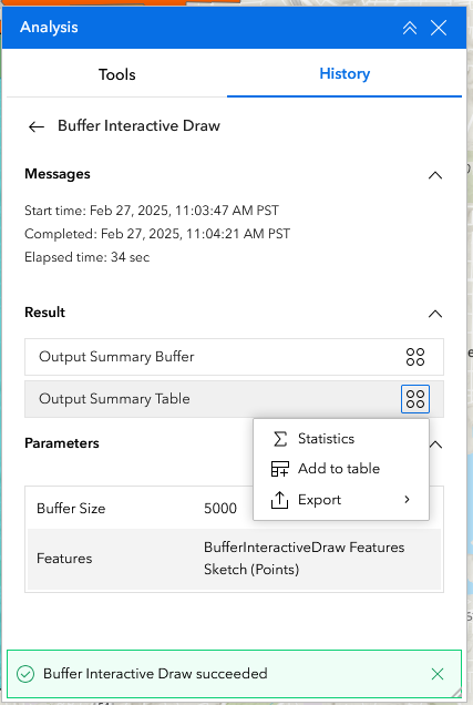

I'm wondering if I'm missing something here. In WebApp Builder, when you use the Geoprocessing widget the output pane allows you to remove the results, which then disappear from the app (first image below). How is this achieved in ExB? I don't see the ability to remove the tool output (second image below). FYI I'm using ExB in AGOL.

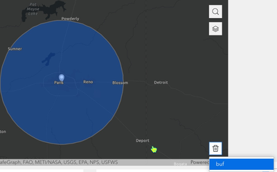

When layers are added to the map by the analysis or add data widget, a (tiny) trash bin icon appears in the lower right corner of the map (In my experience, I need to minimize the widget first before I even see it). If you click that, you can remove the added layers.
Wei_Ying
Hi,
To remove result from map is possible, but it needs to be operate from the Map widget.
Whenever a new layer added to the map at runtime, you should see a trash bin icon at bottom right.
Click it will list you all the layers that are added and you can select the one you want to remove.
