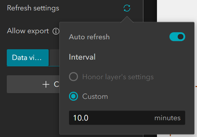

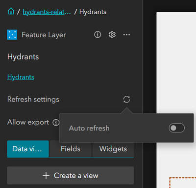

Hi @Anonymous User,
It might be useful if you try the Refresh settings in the Select data doc:
