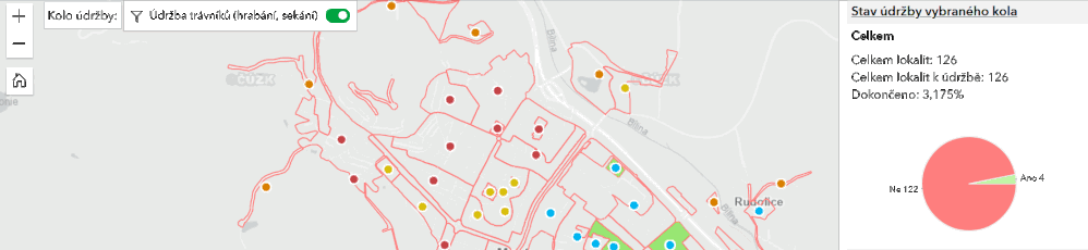

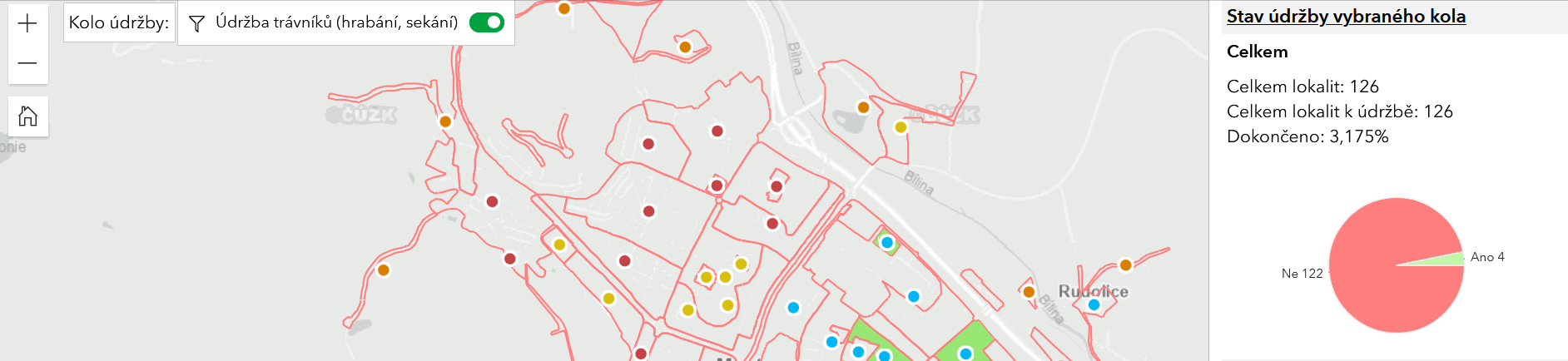

I have created a custom filter widget for ArcGIS Experience Builder (but same issue is with default filter widget). This filter widget filter the data immediately after the application starts. There is also a chart in this app, which is attached to the filtered data.
Problem is that the chart is not sometimes refreshed with filtered data. It depends on the loading order of the widgets.
The issue is shown here:
Is there any way how to resolve this problem with default ExB tools or how can I wait for loading chart widget in my custom filter widget programmatically?

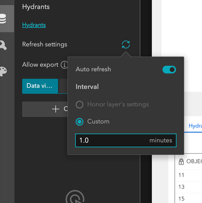

For the first problem, please make sure the chart is using the same data source and data view the filter widget is using. For the second problem, make sure you enable the "Auto refresh" for the data source.

2. Yes, this problem can be solved by "Auto refresh" setting. But I was kind of hoping that there would be something like a trigger in the background that would run an update of the data context of the entire application after editing features. So "Auto refresh" setting is the standard way to achieve this?

2. Yes, we recommend to use "Auto refresh" setting to trigger update at framework level. And you can control the refresh time.
