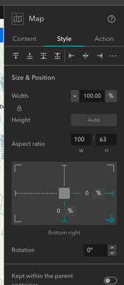

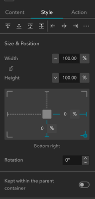

DanJiang
I just saw your shared app. I think it is caused by the map size settings.
Please select the map widget and open the "Style" tab. You will find the size & position settings is set as screen shot 1. Changing it to screen shot 2 will solve the problem.
You set the width as 100% and keep the ratio, so the height of the screen should be 63% of the screen width otherwise it will cut.

DanJiang
Laura_m_Conner
Thank you that was the issue.
