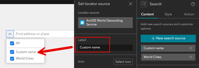

@davidchamberlain2 I think you are getting confused about something that trips up a lot of people new to Experience Builder. There is more than one way to get a search bar in Experience Builder. Built into the Map Widget there are a set of tools. These tools cover common map operations and are designed to be used with no configuration. In fact, the only option provided by these tools is on or off.
Some of these tools, Search, Layers, Basemap, Measure and Select, are duplicated as widgets that can be added from the left side panel. The widgets offer many more options. @ShengdiZhang was showing an option from the Search Widget. You will want to turn off the Search Map Tool and add a Search Widget.

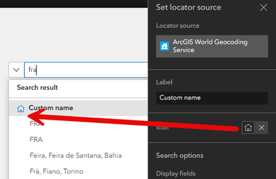

ShengdiZhang
Hi @davidchamberlain2 ,
In Experience Builder, when you select a widget on the canvas, the widget settings will be displayed in the right panel.
Specifically for the search widget, you can update the labels and icons for each search source, and they will be synchronized and displayed in the search box drop-down menu.

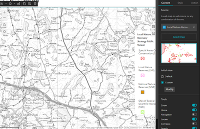

davidchamberlain2
Hi @ShengdiZhang ,
This is the problem. I cant select a widget on the canvas. When I click on a widget it isnt selected, the only time its selectable is when I go into live view. This snip is what I see when I am clicking on a widget, no options come up on the right because the widget isnt being selected even though I am clicking on it!
Any ideas? This is driving me mad!
Thanks
Dave

davidchamberlain2
Thanks Jeffrey. Thats the answer yep. Unfortunately the version of experience builder we have on our portal doesnt have the search widget to add, its not in the list of widgets on the left that can be dragged onto the map. I assume thats because its an older version? 10.9.2? I might have to use AGOL instead.
