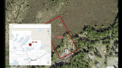

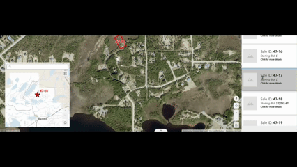

I want the user to have a simultaneous small scale and large scale view of their specific area of interest. This is especially because they may be selecting features from a List widget, which will sometimes instantly "snap" to the feature instead of smoothly transitioning to the next selection. (Shown below...)
Selecting from this list produces the expected behavior. However, if I manually zoom to a scale on Map 1 that exceeds the limit set on Map 2, the second map does not respond to any stimuli until I zoom Map 1 out to a scale that falls within the scale limit.
I was hoping Map 2 would still pan around to match the location of Map 1, while retaining its maximum scale so that the user has an immediate idea of where they are at. It is likely that users will want to utilize both the manual navigation and the list navigation options, so it's frustrating that the extent change on Map 2 is only fully respected when the feature is selected from the list (even when Map 1 is zoomed in past the limit set on Map 2!). Is this behavior possible (or will it be)?
