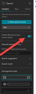

RhettZufelt
MVP Notable Contributor
Toggle this setting off seems to do that.

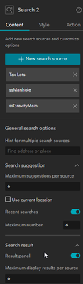

DavidForbuss1
I'm guessing that's something they've added in the newer version on AGOL.  I'm using the enterprise version, so it doesn't appear to be an option:
JeffreyThompson2
MVP Frequent Contributor
This was added in Experience Builder 1.12, equivalent to Enterprise 11.2.
