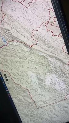

Hey guys I’m working on some web maps for my org and am wondering if there’s a good way to have labels move with the map as the user zooms in!
I’m creating generic esri web maps with a large polygon symbolized by different zones.
I’d like for when the user is zoomed in on the web map that a label is ALWAYS on their screen regardless of the current zoom level or location
My idea is to make it as easy as possible for someone to be anywhere in the map and it still be clear what portion of the map they’re looking at without having to memorize a color!
Thanks in advance!!

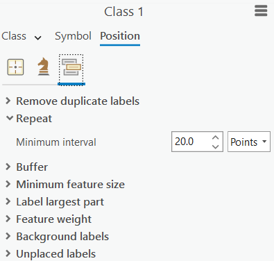

If you have access to Pro: find the map file you publish the layers from, select a layer, go to the "Labeling" tab in the ribbon, click the tiny arrow in the bottom-right corner of the "Label Placement" section: now you have the Maplex positioning options. Click the third icon from the left to go to the conflict options and set a "Repeat". This will saturate your polygon with labels, even if the centroid is offscreen. This requires overwriting the map service or publishing a new one, and I'm pretty sure this won't work with your Feature Service (it might work with a vector tile service?) but it'll give you all the labels you could ever need.
That said, as others have mentioned: this is what symbology is for. A well-authored set of polygon symbols will make your areas easy to delineate and will work in all types of service. If the user has trouble remembering each symbol they can open the legend built into every web map.
