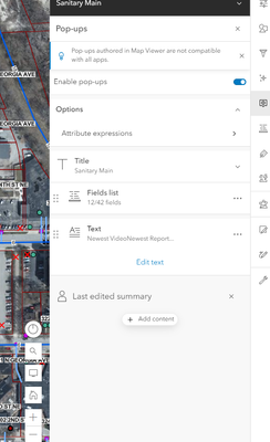

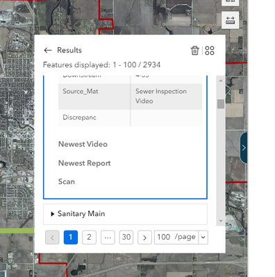

I use hyperlinks instead of attachments: Within mapviewer I have configured my popups to display videos and pdfs using the text option of the popup. Here I link it to my IIS and everyone can then view it. When you choose 'Use webmap settings' in the results pane of your query in EXB that whole popup will be what shows up after your query. Just have to configure it all in the map.
You should be able to add attachments within the popup pane of the map and follow a similar workflow.

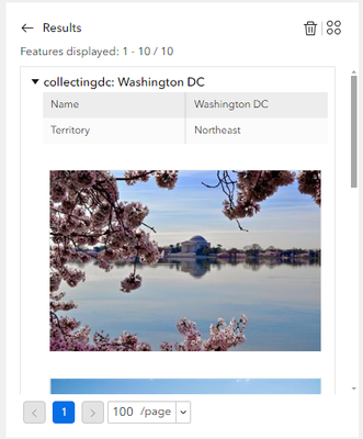

Query does support display attachments. Let me know if you have further concerns. Thanks!
