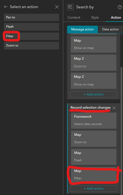

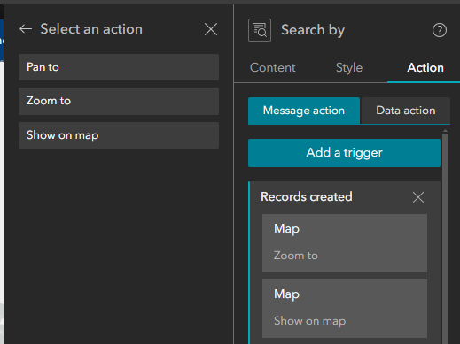

My users would like the query widget to only show the results on the map. As it is right now, the results show in yellow but the other points are still there in blue. Because there is no Records created action for Map Filter. Only Map > Show on map and Map > Zoom to.

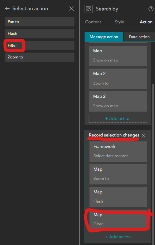

We do have a Record selection changes action for Map Filter, but that's only good when the user clicks on one of the results in the Query widget list.
I have to use the Filter Widget for a way around this, right?

Thanks for the post! I recommend using the Filter widget configured with the 'Zoom to' message action to achieve the intended goal.

AndreaB_
ok thank you for confirming.
