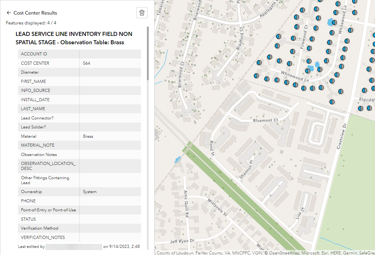

Hello,

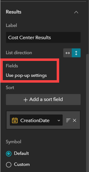

I am using the query widget to query a table within a webmap. The 'Results' panel allows me to successfully change the label and add a field to sort by.

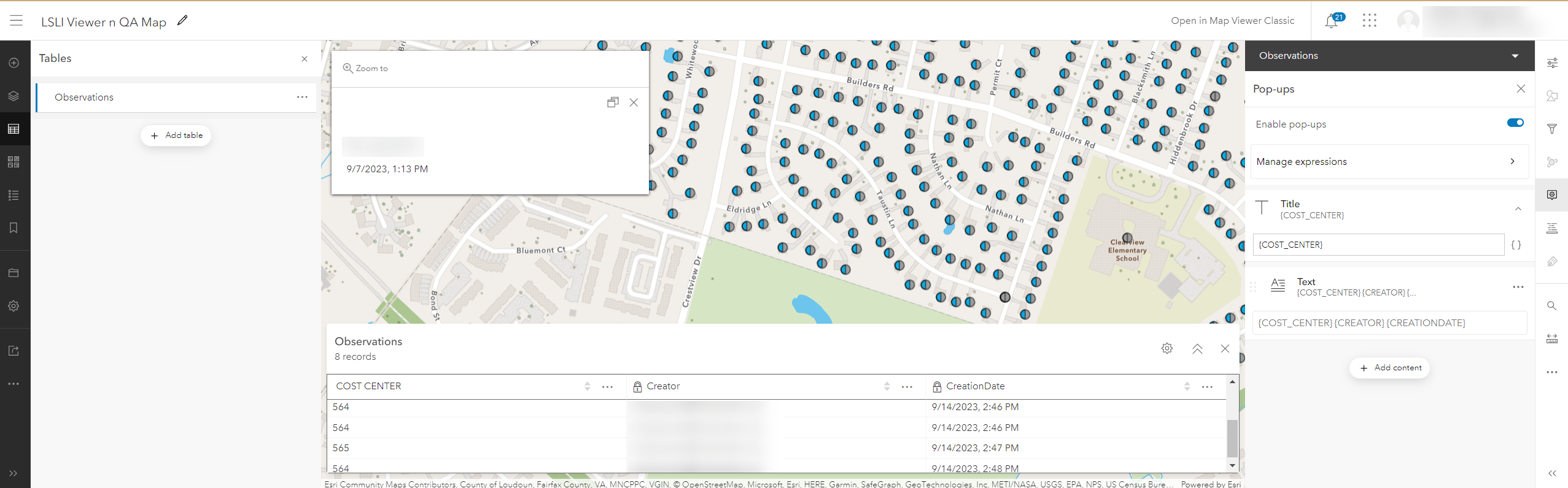

I set up the map popups to display only three fields: COST CENTER, CREATOR and CREATIONDATE.
However, the display of the widgets results does not use the popup set in the map but simply displays everything in the table.
I am using Experience at 10.9.1
ahargreaves_FW
This was confirmed as a defect and became BUG-000161559: Query Widget Results Panel does not honor the Field Pop-Up settings for a hosted table in Experience Builder in ArcGIS Enterprise 10.9.1
