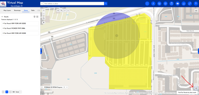

Hello,
I have an ExB app using the query widget to carry out a number of different searches. I can use the Action to highlight features from the search results using 'Show on map', however, I can't work out how to clear the highlighted features. New searches just add additional results to the highlighted features. Clear Search clears the results, but doesn't remove the highlight from the features. Can anyone help?

There are two trashcans associated with the Query Widget. The one that appears in the Query Widget itself clears the search results.
A second trashcan will appear on the Map Widget (always in the lower-right corner?) after pressing show on map. This trashcan will clear the highlighting.

Somewhere on your map there will be a little trash can. That is how you clear the query highlights.

Thanks, that doesn’t seem to work for me. It clears the search results but not the highlight on the map.

Ah, brilliant. Got it, thank you.
