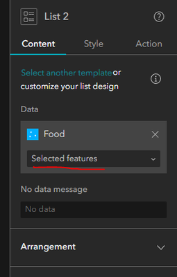

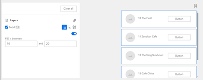

You can configure the same SQL expression within a Select widget instead of a Query widget and set your Parcel List to use the 'selected features view' of the same data. This will help you achieve your intended goal.
