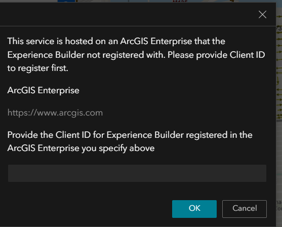

When I try to run an EB application that uses a web map with a layer that is password protected, it pops up the following error message:
"Provide the Client ID for Experience Builder registered in the ArcGIS Enterprise you specify above"
How do we fix this issue?

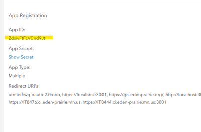

You'll need to find the client ID of the Experience Builder app you registered in Portal/AGOL:

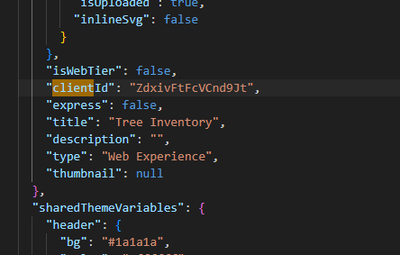

Then, open up the cdn folder of the downloaded application and open the numbered folder, then open config.json:
Find the empty clientID property and paste the value from the app:
