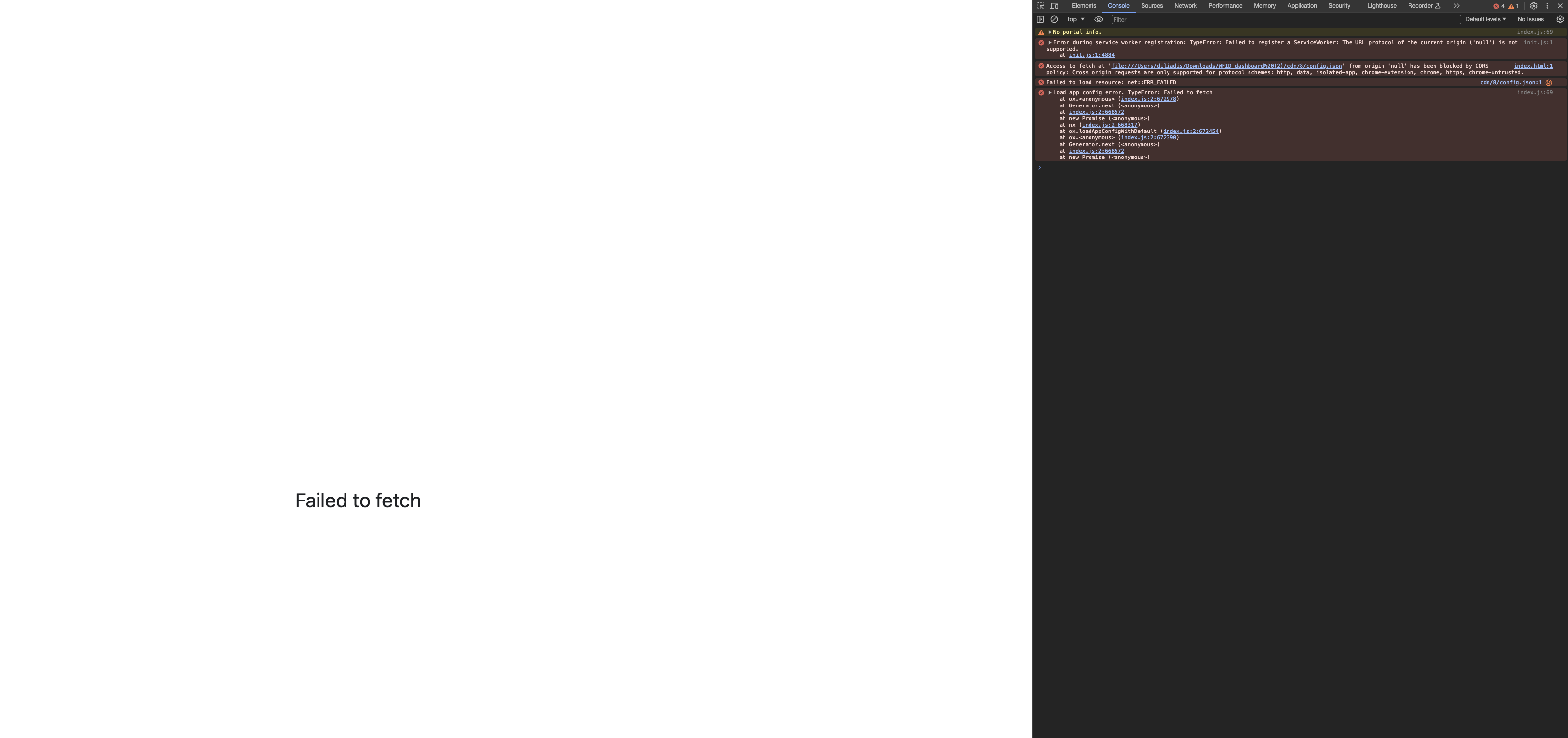

From the documentation I see that I have to download it (using the download button in the experience builder UI). This returns a .zip file. If I unzip it and try to open the index.html I get a black page with the "failed to fetch" text at the center of it.

You need to copy the unzipped folder to the Web server.
Deploy the experience
To deploy the experience on your web server, complete the following steps:
  1. Unzip the downloaded experience and copy the folder to your web server.
Deployment | ArcGIS Experience Builder | ArcGIS Developers
