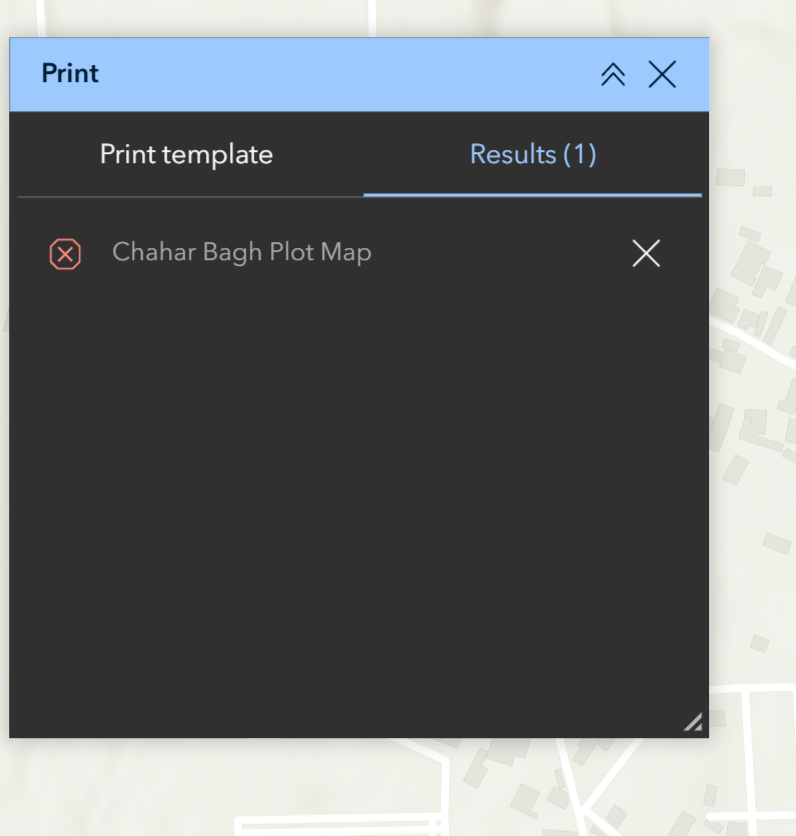

When I fixed the printing widget in experience builder and perform the task, received the following error;

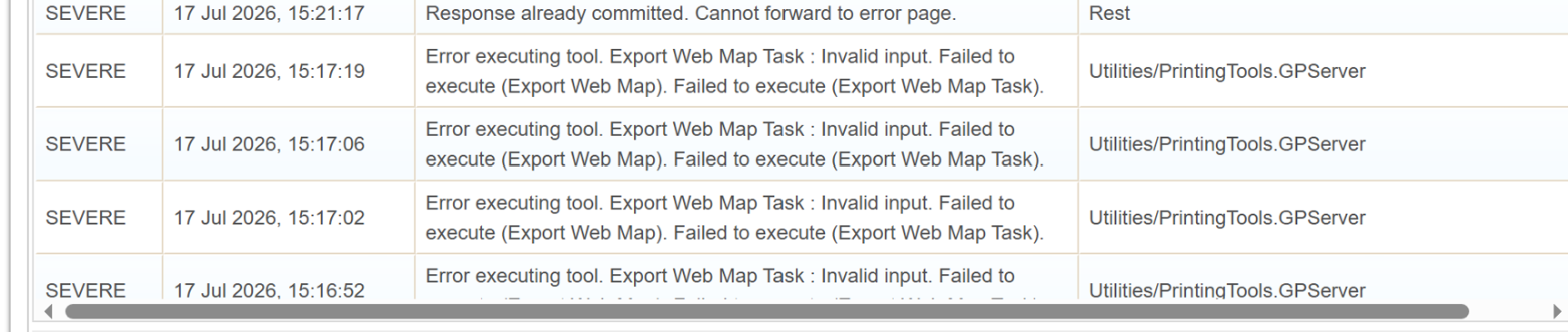

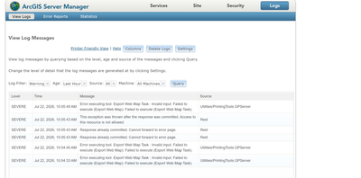

I checked the ArcGIS Server Manager tools, it is working. the log detail is given as;

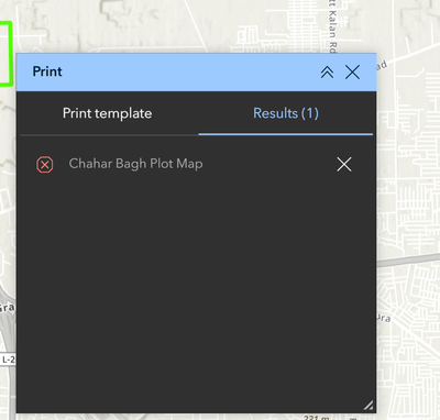

actually, there is no restriction on any layer and data can be seen in expereince builder but not working the printing widget.
the log error is given as;
  • Base map prints successfully
  • Layers added at runtime using the Add Data widget print successfully.
  • Any published Map Image Layer or Feature Layer in the web map causes
This indicates that the Print service is failing while processing one of the operational layers.
