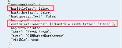

Hi @RachappaBellappa1 ,
Can you execute the print service - Get Layout Templates Info Task to see if the Layout Options - hasTitleText is true? If this parameter is false, the title will not be dynamic.

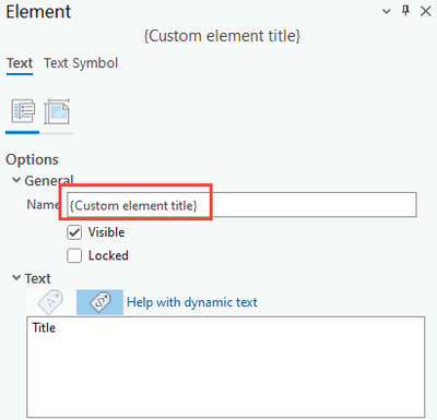

You can add custom text elements to the print layout from the Pro by using "{}" around the text element name:

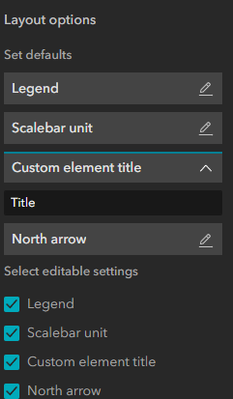

Add a print service with custom text elements to the ExB and the custom elements can then be found under Print Templates - Layout Options:

RachappaBellappa1
Thanks @ShengdiZhang it's working now, Also just a suggestion if you guys could update the documentation it will be helpful/
