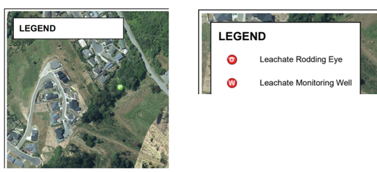

1 - The legend does not populate at all, even with the 'Show legend' option ticked.
When using the exact same print service and map using the WebAppBuilder print widget, the legend displays with no issues in the print (left is Experience Builder, right is WebAppBuilder).

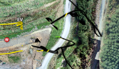

2 - Layer effects created in the new Map Viewer (such as drop shadow) do not render properly.
I've found it introduces weird graphical glitches, and labels/symbology seem to be blurry/distorted. The black lines introduced below go away after the drop shadow effect was removed from the map. This problem doesn't seem to be limited to just custom templates however, the default print does this too.

I've replicated a simple map/ dummy data in this experience using the same settings, using this print service. I noticed I wasn't able to replicate the same graphical artifacts in the map again using a drop shadow effect, so maybe that was just a hangover from a specific map/layer configuration. The legend is still absent though however.
