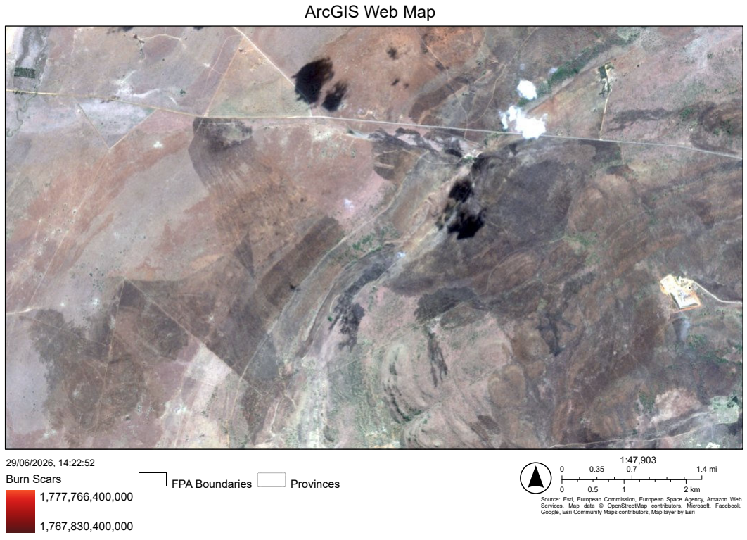

I have a web map with a polygon layer and the polygon layer is styled using a date field, from oldest (lighter red) to newest (darker red)
When using the Print widget, with default print utility and default settings, the polygons do not show on the print map and the styling is not kept in the ledged of the printed pdf.

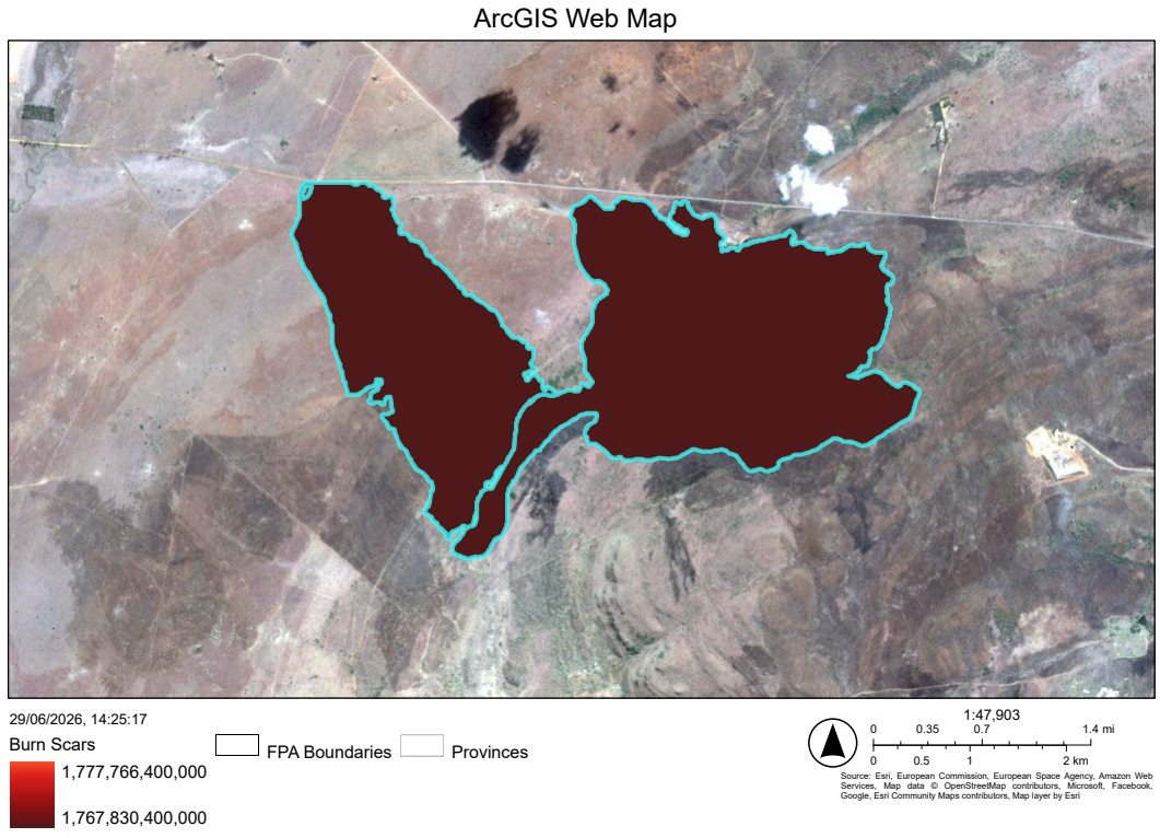

When I select the polygons on the map first, before using the print widget, then the polygon shows on the printed pdf map but the styling is still incorrect.

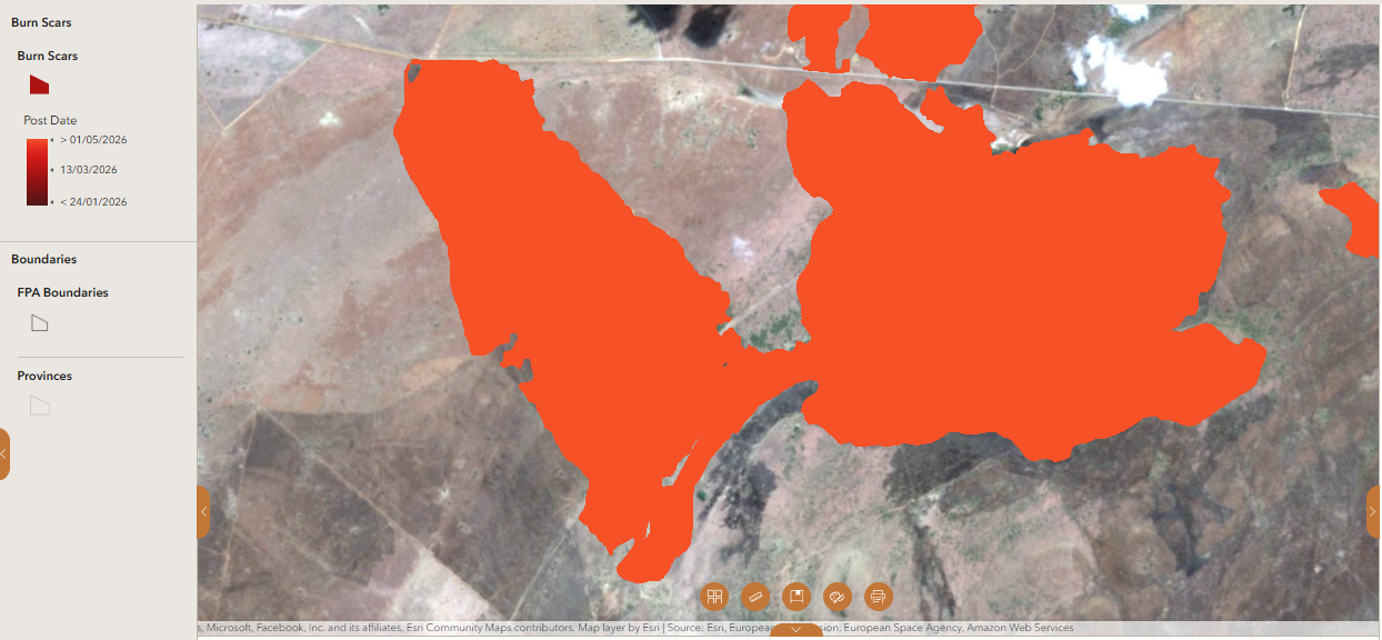

With some deeper investigation, it appears that the following occurs:
When the map's extent change action is set to filter the data framework the polygons do not appear in the printed map.
When turning the extent change action off then the polygon's appear on the printed map.
BUT, the styling is still not correct...
How do I now get around this if I still want the extent change action to filter a table but also allow the Print widget to print correctly?
