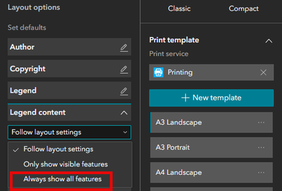

Hi, I tested your app and what you’re seeing is expected behavior.
Before the February 2026 AGOL release, the Print API did not support dynamic legends, so all features were always displayed in the print output.
Dynamic legend support was added recently. However, because this app was created before that release, the print widget still uses the previous settings and behavior to avoid introducing unexpected changes.
If you’d like to use the dynamic legend, you can simply remove and re-select the print service in the print widget to update the template settings. After doing this, the print output will include only the features that are visible in the legend by default. If you prefer to include all features in the print legend, you can enable "Always show all features" in the print template settings.
Please let me know if you have other questions.
Thanks,
Shengdi

As @ShengdiZhang said, it should work. We are planning to roll out some enhancement in upcoming enterprise release to control that from Map Viewer and ExB side.
Until then you can set a flag in the layout template to only display legend patches for visible features. You need to that in ArcGIS Pro while authoring the template.
please see this help for more info: https://pro.arcgis.com/en/pro-app/latest/help/layouts/work-with-legend-items.htm#ESRI_SECTION1_2A684...
