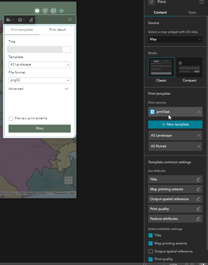

I've added in the print widget. We have a hosted tile layer in the map, but noticed it didn't appear in the map output. Does the print widget work with hosted tile layers or only feature layers?

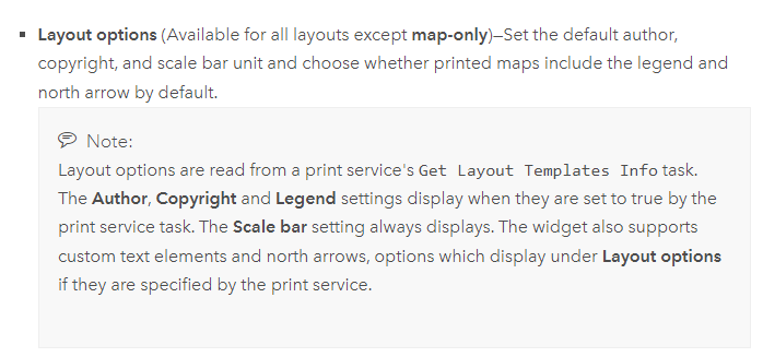

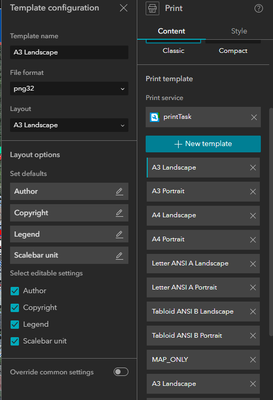

I also noticed the legend and north arrow did not appear. AGOL ExB documentation provided the below advice. How do I access the Get Layout Templates Info task? Where is that? Is someone able to upload a video or provide some screenshots on what I need to do to enable these settings?
Configure print widget documentation - https://doc.arcgis.com/en/experience-builder/latest/configure-widgets/print-widget.htm

So you will be using the out of the box Esri hosted print service and the templates that it provides. Those templates (as far as I know) do not have a north arrow, so you wouldn't have one on the output.
Regarding the legend, what layers have you got in the map? If the its just the hosted tile layer, then it probably won't show this if its been set as the basemap.
The get layouts task is available here https://utility.arcgisonline.com/arcgis/rest/services/Utilities/PrintingTools/GPServer/Get Layout Te... but you don't really need to access that, you should be able to configure the options available in the widget, by selecting a template.

Marokapara
Hi @Grant-S-Carroll ,
Your reply was helpful. Thank you.
I pulled out the print widget, put it back in, and then the hosted tile layer showed in the map extent. I had it at the basemap level. Maybe I had an issue because I had it in there before the last couple of upgrades.
For some reason I thought a north arrow was included, but you're right that's not part of the widget yet.
