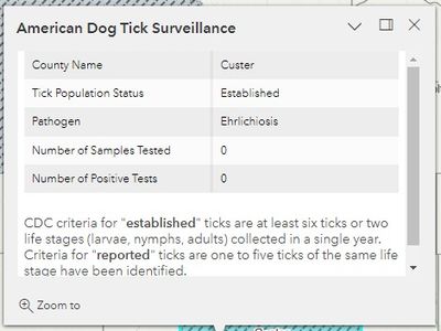

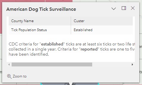

In the first view the popup has a horizontal scroll bar.

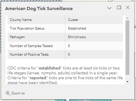

In all other views the popup has a vertical scroll bar.
Is there a way to control which direction the scroll in the popup works?
The preference would be vertical scroll, but consistent would work too.

Jennifer_Parmeley
Thank you! yes it was a map issue. I just wasn't seeing it until I put it in ExB. The map popup element inserted first determined the scroll direction. (or something like that)
I deleted the text and added it back in and the horizontal scroll was removed.
