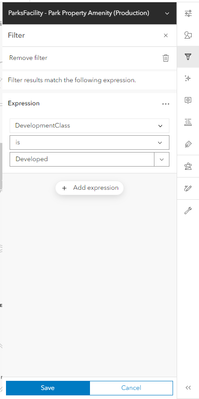

JeffreyThompson2
MVP Frequent Contributor
Have you tried setting a filter in your webmap? If you want to hide something and never unhide it, it is a simple solution.
From your description, this sounds like an issue where React is triggering a re-rendering of some component that is removing your definition expression. There is probably a way to write a useEffect hook that watches your definition expression and re-adds it if it is removed, but it will be tricky to find the right way to do it without triggering an infinite loop.
