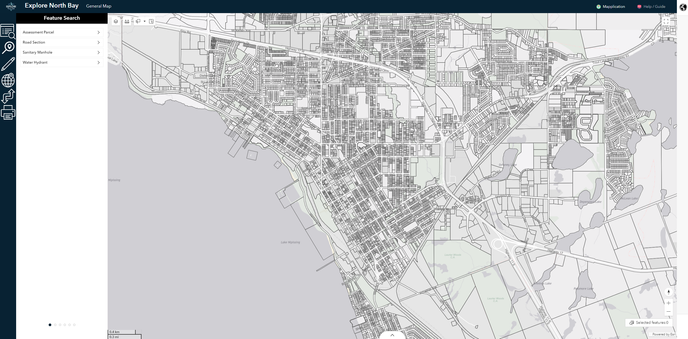

I'm thinking it has to be some kind of bug, see attached screenshot of what the app looks like:
JeffreyThompson2
MVP Frequent Contributor
You have some non-standard icons. How does the Feature Search work? Are you using any custom widgets? It's possible one of them is interfering with the popups.
