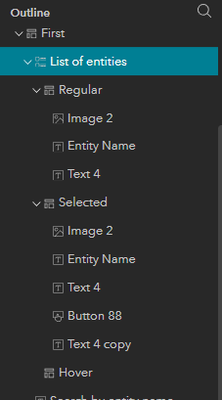

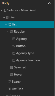

One thing I did note that was different between my experience and the one I am using a guide is that in their Experience there is List Widget configuration under the Selected state.  Maybe that's the problem?  For the life of me I cannot figure out how to build anything under the Selected State on mine.  I do have considerably less changes apply when a List item is selected (just an outline added) than theirs.

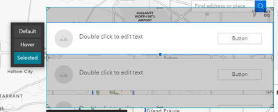

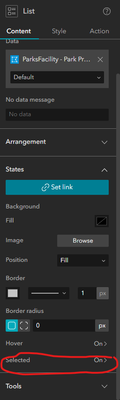

I didn't know about these options until you just asked. Setting the options for Selected State allows you to display list items differently depending on if the item is unselected, selected or if the user is hovering over it. It could be very useful to make a design like 'only show the item name if it is not selected, but show a picture and full description if the user is hovering or has selected it'. This won't fix your original problem, but here's how to do it.
In List widget, settings panel hit selected or hover
Then Custom and accept warning
Redesign your list as desired. Switch between states with buttons on side of list.

Interesting.  I have enabled selection, which is how I was able to get selected list item to highlight, but did not create a custom layout.  I assume that's the extra content under the Selected State...

Once you have enabled the custom layout option, you can go to your list and modify it as you see fit and that modified version will appear in the state it is set in.
