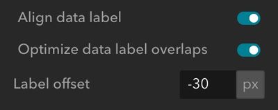

It is a known limitation that data label maybe cut off when chart size is small. The workaround is to turn on label optimization options as below and also adjust the label offset to make the labels closer to the slice.

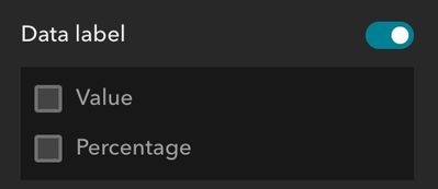

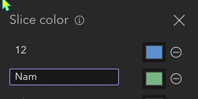

Another thing you can do is make a separate chart to customize a different setting on mobile, where you can rename the slice to make it shorter. Or check off percentage/value display to make label shorter on mobile.
