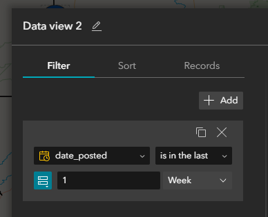

Create a Data View based on Is In The Last 1 Week and set your List to use this Data View as the data source.

Or you can either filter the layer (globally) in Experience Builder, or create a data view (specifically for use in your list) in Experience Builder:
