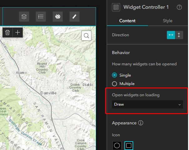

To add to what @jcarlson is saying. The widget controller is responsible for that. Say you are using the foldable theme and adding a widget to the widget controller in the apps header. You will see as outlined in this image you can set a widget to open at start.

You can also add the widget to something like a sidebar tab or its own floating window, which can be adjusted to show when the page loads, too. But the widget controller is probably the simplest.
