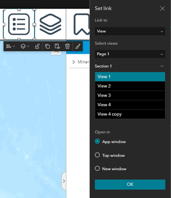

Would someone be able to elaborate on these steps? I am looking to create the same idea as the example map shared here - using the buttons to show a docked layer list or legend but am having trouble linking the buttons to the widget.
MarcoPoetsch
@Anonymous Userif you click "Set Link"  you should be able to link to different types. One of them should be "View". This will extent your options and you will see "Section"
Does this help?
