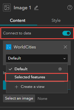

If you want to make a more flexible layout, you can connect the image widget to the same feature layer used by the map widget, and choose the selected features view (same for text widgets).

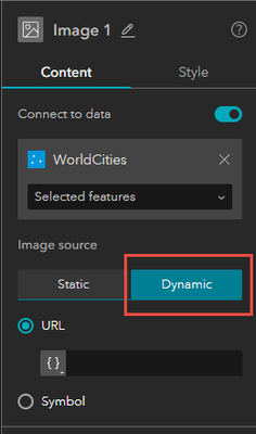

Then change the image source to Dynamic.

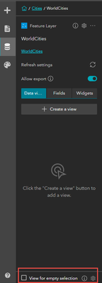

If you don't want to show a placeholder when no feature is selected, you can check the option "View for empty selection" on the Data panel.

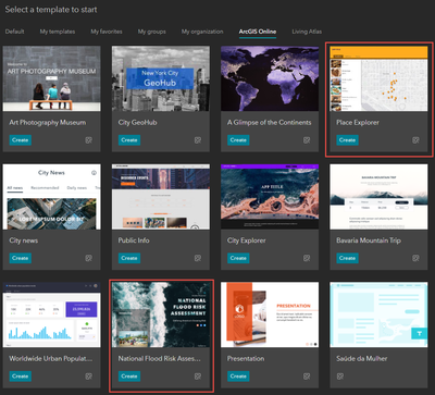

One is to replace the current bookmark widget with a list widget, and add a Record selection changes - Map - Zoom to message action on the list widget. You can set a link to another view from the list widget (or a button on the list). Sample app: link
Another one is to use a fixed panel to display feature info in the lower right corner. Here is an sample app: link
The above apps can be created from online templates:
